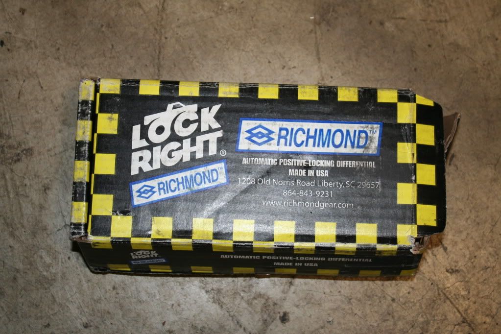

well i have been busy i've cut just about all the ifs stuff off. just a couple diff mounts remain that i didn't see in the way atm and i'll cut off latter. Now, im no welder by trade, so it looks pitiful at best but im getting the job done & nothing a grinder and more welding wont fix ;D i do know im glad this is a trail rig and a winter snow driver rather than a DD . im doin my best but i still feel like some thing isn't going to be right with my alignment lol. spring hanger tack'd in for checking alignment. driver side out side front shackle hanger. i used a torch to blow the hole's and well had some gaps to fill once i liked where the tube's liked with every thing attached and tight. pass side in this pic you can see how i'm going to need to change my exhaust to allow for front drive line droop oh i also got some new stuff; tires, i went with 35x12.50x15 km2's mounted on 7in wagon wheel's and they look more like 10.5's this way lol. i aquired a lockright through ebay, was searching google for best prices and it popped up in my search with a part number 1610-LR and was put up as a 90-97 landcruiser front end. and after alot of searching i figured the company he bought it from listed it only for his rig. and also put LR behind the part number to indicate LockRight. goofy i know but i scored it for 237 shiped and it's new in a rough box , ie never installed. i need to change pitmint arm's to work with the hysteer and fj80 rod end's. also need to consider the best parts place to order a double acting ram for hydro assist.. it looks so easy to install i figure it'll be a well worth it mod

i deinfitly been thinking about snow season in a few ways. i plan to get a ten x pass to meadows this year ;D and i already know two different groups that sound like they make a killer trek around different area's of mt st helens. well right now im in the process of tearin down a mkiii 4.10 diff to install into my front end w/ a lockrite in it. i also need to find a shop/person who has a press w/ tools to press out the steering arm pin's. the mechanical press i have access to doesn't seem safe oh i did read for those interested , 86-92 supra's mkiii's have an 8" irs set up and the ring and pinion "should" work in both 4cyl and v6 diff's. and the carrier housing will fit v6 bearings and fit the v6 housing. tho i also read some one had it machined down to 4cyl bearings with success. also the open i have tore apart Was a 4 pinion diff.
