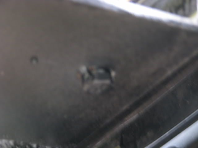

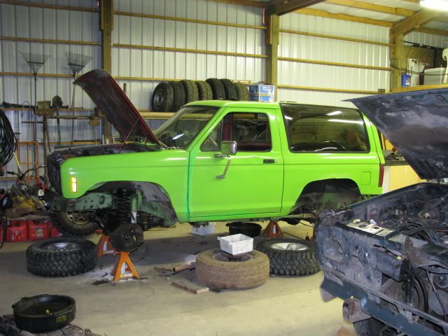

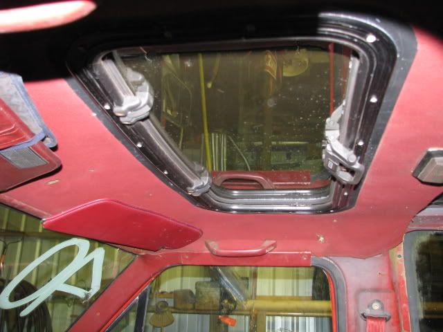

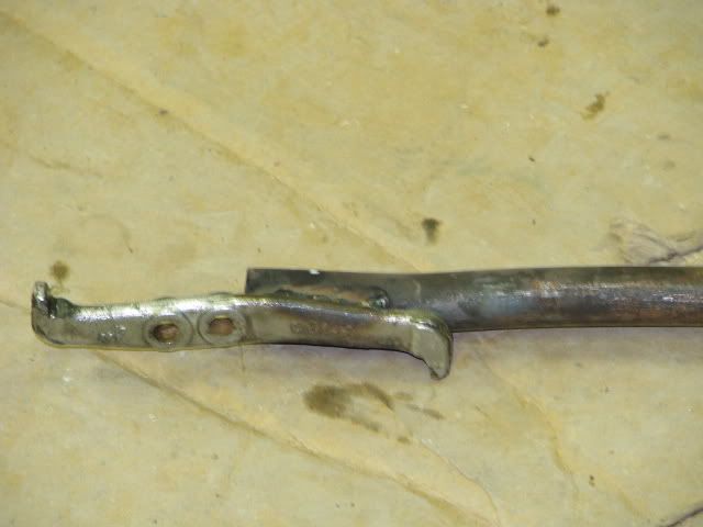

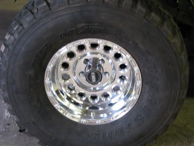

Here are some photos of "SLYMMER" We have done some work and some modifications. Especially spring spacers! Robbing Frogger to build Slymmer! Darel's handy work. The sun roof has a lime green mood lighting. Yes they painted over the window And again, Darel and Rick's handy work. When you don't have the tools that you need....BUILD THEM! The custom "slide hammer" to remove the axle bearigns. SLYMMER got some new "shoes" And this is what you can expect to see on the trails! The mean little green machine!

I love that slide hammer, I will put a picture of the one I used, its built and ugly. It worked good though. I feel the pain of not working. Its been very slow for us lately too and funds are dwindling. Hope to see you one the trail soon. home made slide hammer. A used axle and some weight. It was to pull wheel bearings on my datsun pickup since you have to pull from the studs on the axle.

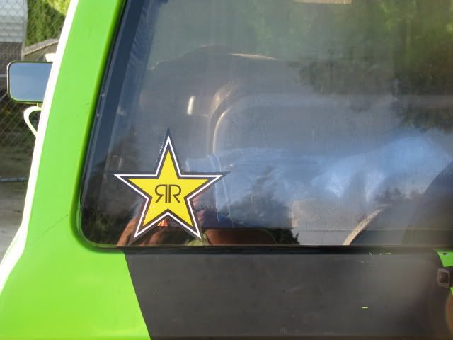

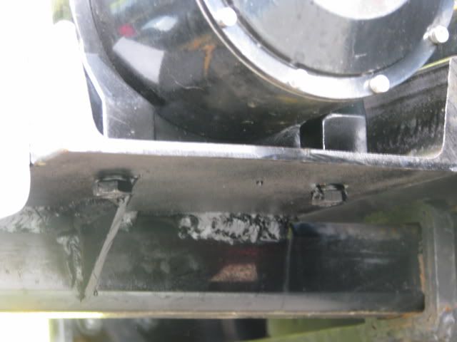

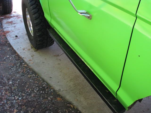

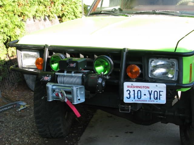

It's been a while since any updates have been posted for Slymer. Thanks to Darel for all the fab and welding that has been done. I owe you!!! First the winch, winch plate & receiver... Even the mounting bolts are welded on!!! Then came the rock sliders...can't wait to try them out! (still not painted on the bottom side!) The semi-finished look... And yes Slymer would not be complete without a RockStar sticker on the back window...just need the Skittles sticker and it's set!

I love that slide hammer, I will put a picture of the one I used, its built and ugly. It worked good though. I feel the pain of not working. Its been very slow for us lately too and funds are dwindling. Hope to see you one the trail soon. home made slide hammer. A used axle and some weight. It was to pull wheel bearings on my datsun pickup since you have to pull from the studs on the axle. Haha! Looks a lot like Jim's!

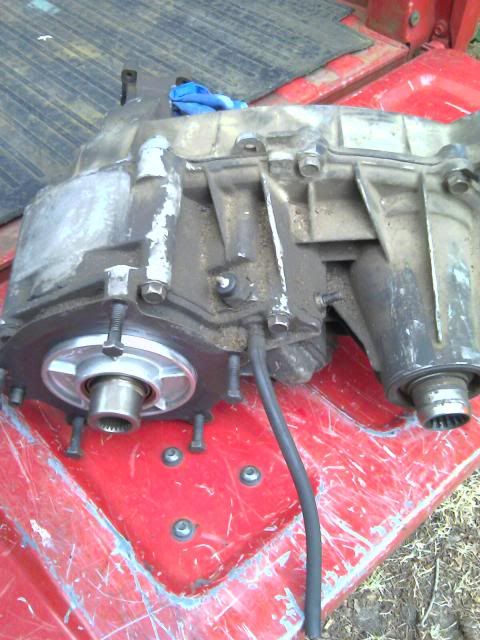

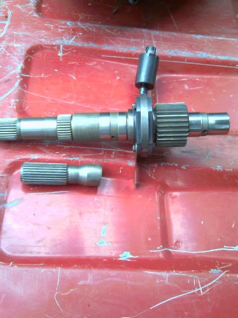

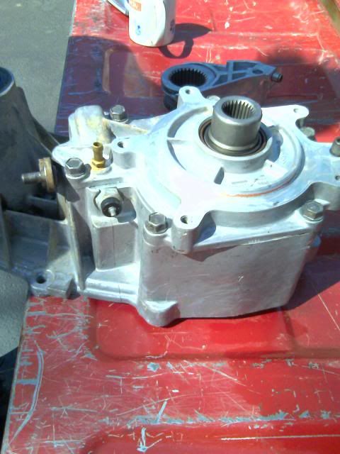

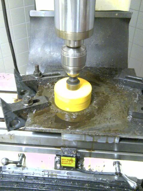

After wheeling Slymer for awile now most of you know that I wanted to build a doubler. This is not an easy task on this type of rig but I finally rounded up all the parts to get it started. Thank you Crystal for picking up the steel plate for me. It started off with two of these. With the help of my son Darien we took one case apart and this is what it looks like inside. Then it was off to Patrick's shop to do some cleaning on the case's. Thanks again Pat for all the work and that new non chemical washer. Can't wait to see that motor in your Jeep. Then it was off to the Jondahl's to start the fun work. First we cut the open case to make the doubler part. Then we started the plate which has to be cut just right to join the two halfs together. After the big hole was done the Jondahls invited us in for dinner and then they got the call from there son up north that the baby was on its way. So the doubler will have to wait for a bit. Thank you Winton and Maureen for the use of the shop and the knowledge and the food and congrats on the new grandbaby. So after the plate is done we have to make the sector shaft which is the tail shaft of a tranny and the full shaft of the trans case. more pics and write up to come.
