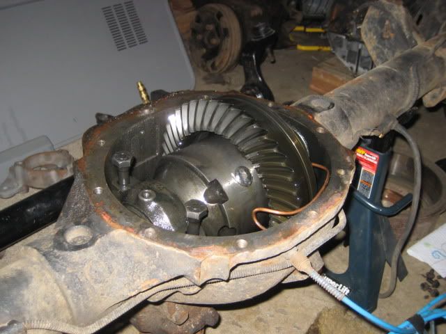

OK....I have a problem here. I cant seem to get the pin out to access the C-Clips on my axles. I removed the small Allen bolt holding it in and still no budge? It also looks as if I have to remove the ring gear to get the pin past? This is on the ARB for my rear 8.25 axle Please Help!

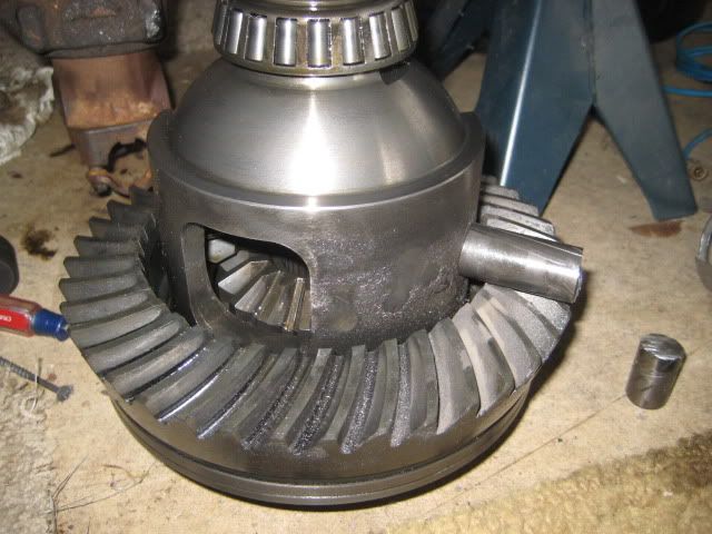

I think I may have found the problem myself. There are 2 pins to remove the guts of the locker. The cross pin bolt is broke off inside and somehow I have to extract it. SHOOOT, this is gonna be fun. Just a shot of the locker. These are the two pins that hold the Cross Pin and Cage Pin...slightly different

Well, I called ARB and they told me a bunch of stuff. Basically he said you should try a big hammer first. So thats what I did, and it came out ok. The cross pin is toast, especially since I had to cut it up, and I have yet to take a look at the gears. I am really hoping I can use the gears because they are 230 bucks or something like that. Bummed out on the whole deal at this point. I could be in this thing another 300 bucks easy. If anyone has any hookups with ARB or knows someone that can take care of me that would be awesome. Here is a picture of it out, finally. I still have to drive out the pin all the way and pull the gears to see if I can use them.
Post by fivendime on May 3, 2010 15:30:17 GMT -8
Just pulled the pin out completely. I noticed that one of the gears has a burr inside where the pin goes through, so my guess is that I will need gears and a pin. I did however find that its a 29 spline which is a plus, but on the flip side I tried to remove the ring gear and 2 bolts broke off so I stopped there and am waiting further instruction of how to get them off without breaking them....anyone?

Post by shortbus on May 3, 2010 16:04:26 GMT -8
heat the bolts they may have locktite on them
Post by fivendime on May 3, 2010 16:32:09 GMT -8
heat the bolts they may have locktite on them I heated it up and still the same thing. I was using map gas so It wasnt super hot but I held it on there for like 2 min and went right to the impact and snap....same thing. Really thinking about snapping all of them off and just getting new gears at this point I've had it. Figured it out Left Hand Threads
