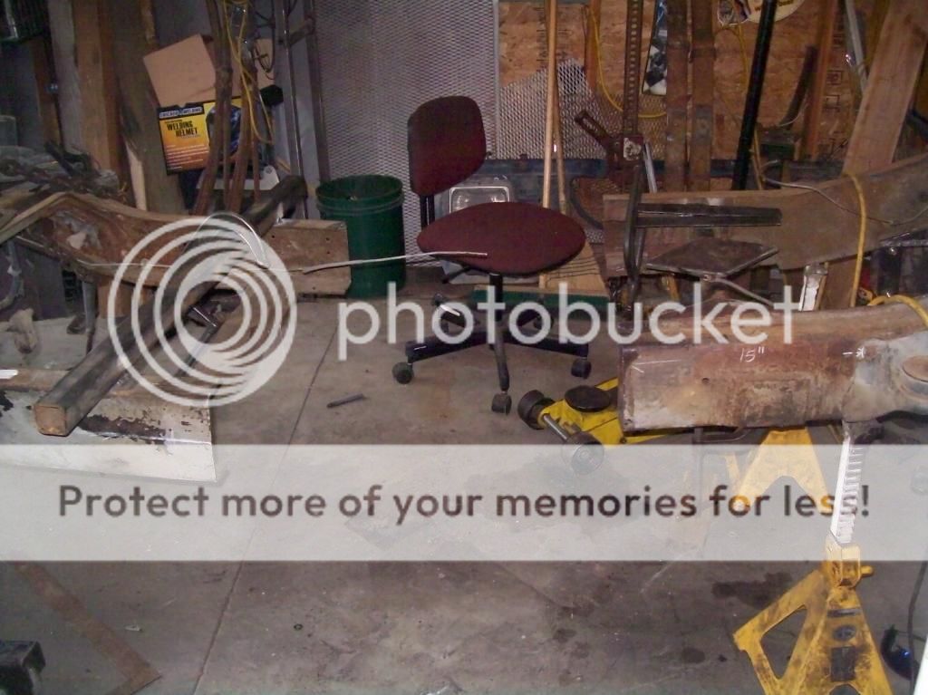

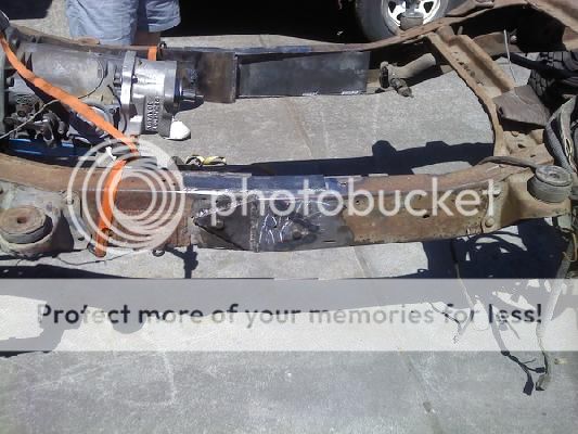

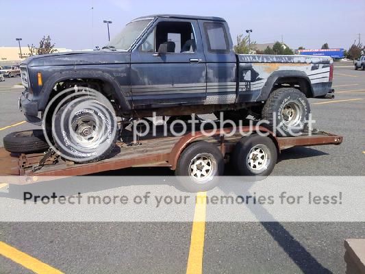

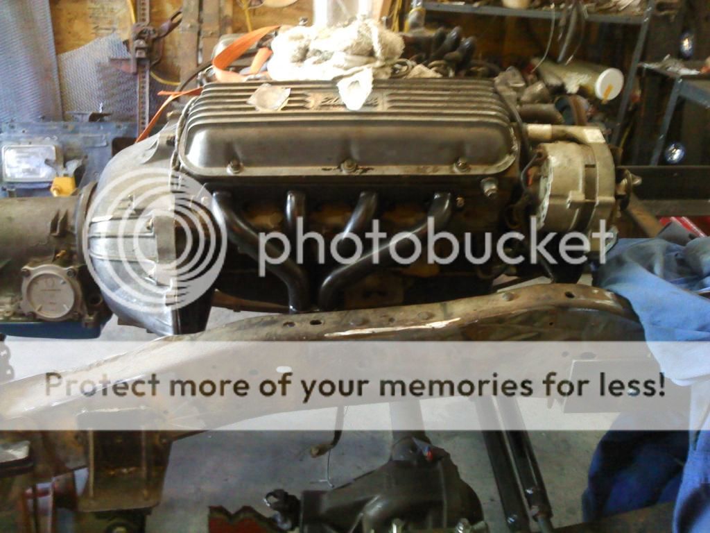

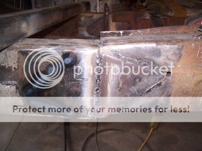

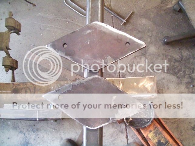

Hey, I have not posted much on this form, I am not a big tech guy. But I thought I would share what I was working on with you folks. I had a cj spring over that was rusted out and the frame kept cracking, so I moved on, kind of. Kept the running gear and now have it in a ranger. It looks funny with a passenger side drop. I am getting close to putting the cab back on it. So this is where we are 302 dual fuel C5 that has been upgraded to handle the 302 Dana 18 twin stick Waggy 44’s with 4.88 and arbs , flat top knuckles w/ 1 ton chevy ends high steer Leaf spring conversion up front And 63” chevy springs out back I have also taken 16” out of the frame. as soon as i can figure it out i have a few pic's to share. coming home from tri cities CHOPPED splice plate 3/8" plate fit perfect [imghttp://i905.photobucket.com/albums/ac254/dad98684/100_1986.jpg][/img] back together

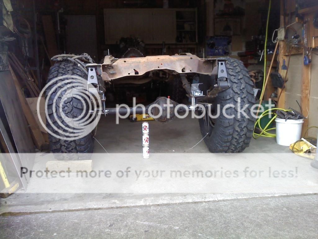

Post by ljdude on May 31, 2013 9:37:27 GMT -8
Wow! Three Rainbeers worth of ground clearance. That's impressive!

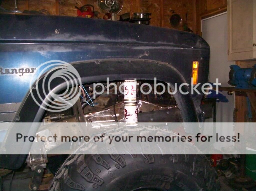

Post by 4stgmby on May 31, 2013 10:27:49 GMT -8
Wow! Three Rainbeers worth of ground clearance. That's impressive! 3 empty rainbeers

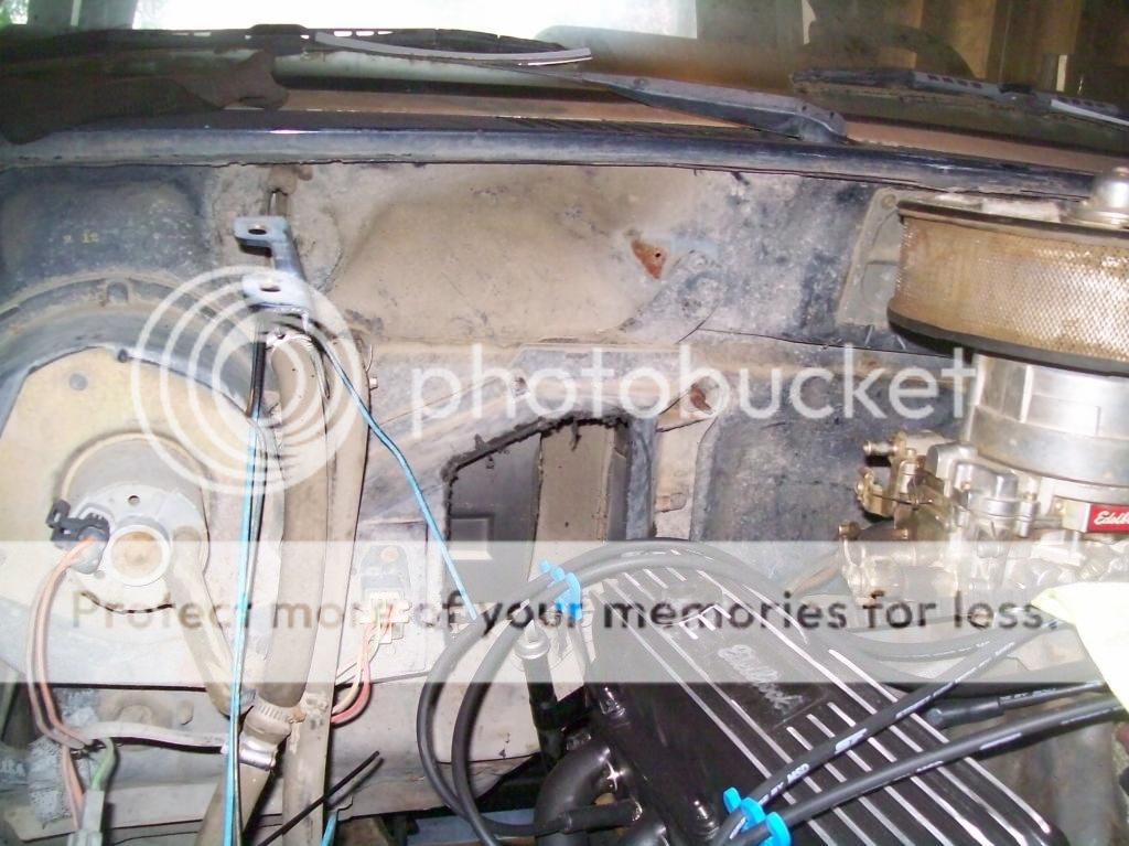

Post by 4stgmby on Jun 3, 2013 12:43:15 GMT -8
i got a lot done this weekend and some of it was on my project. my standard unit of measure getting closer. i have moved into the 80's now with electronic ignition, i have been running dual points for ever. i may need some help with the wiring.
