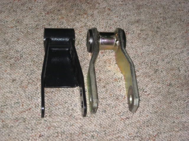

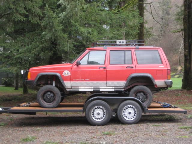

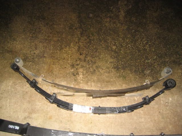

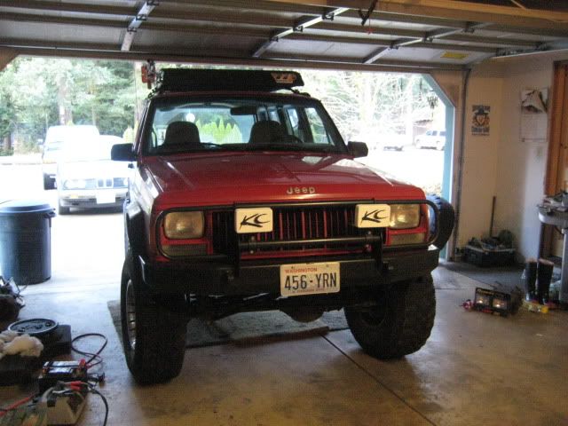

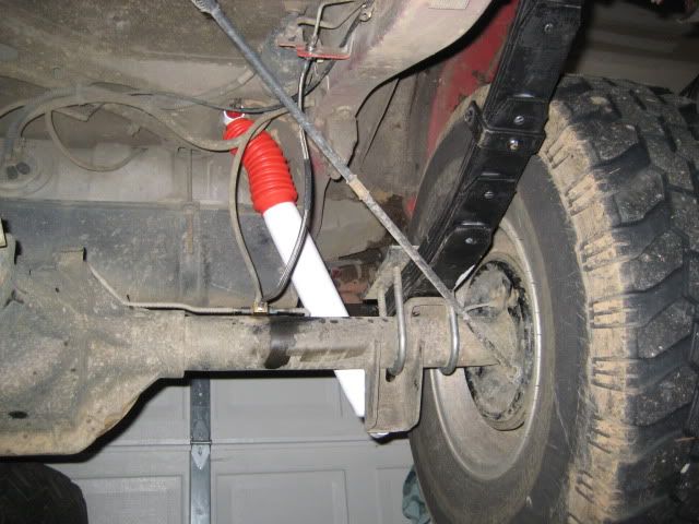

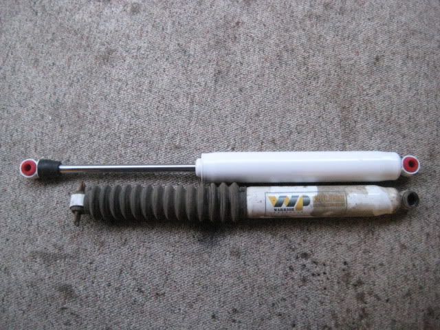

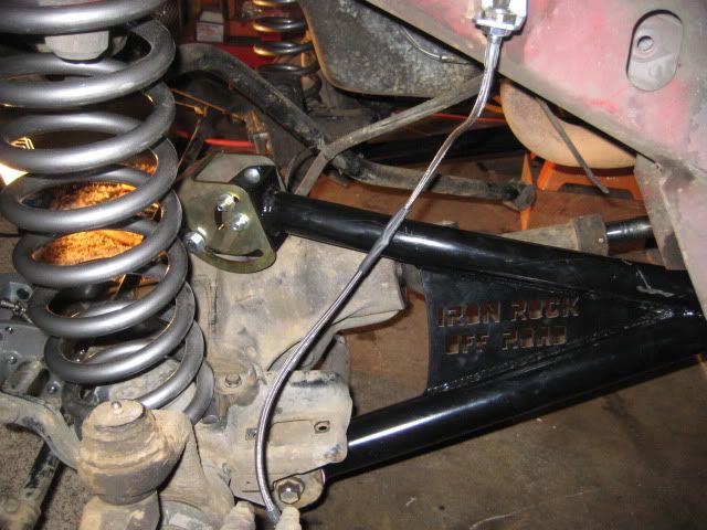

Here are some pictures. All the parts came out good and the new ones went back in just fine. All thats left with the back is to bleed the brakes. I will have to admit I may need some larger tires....or at least wider ones, my wife just mumbled somethin.......I wonder what it was ;D This is its height before the lift...my trust little door welcome bear was the measurement for size of before and after. This was close...I had to air down to get in, not gonna be that easy on the way out. Pulled the shocks to compare and replace. The old shocks were still in great condition. I think they only have about 10K on them if that. Pulling the springs and shackles. The old shackles looked stronger then the new ones. The black ones are from the new lift. Again the parts that are coming off are in perfect condition which is nice for re-sale. Here is the difference with the springs. The military style berlin eyes for the front should work awesome. I may use the add-a-leaf if the XJ sags when I tow my little trailer, but I will need new U-Bolts. Everything has gone together great so far. I greased the heck out of stuff and put a fair amount of anti-seize on the leaf spring mounting bolts since the nut is welded inside the frame rails. Put my new stainless line on the back so bleeding the brakes is all that's left for the back end. NOW for the fun part...the front
Post by fivendime on Jan 26, 2010 20:27:01 GMT -8

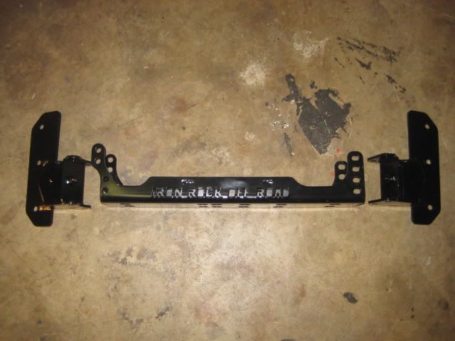

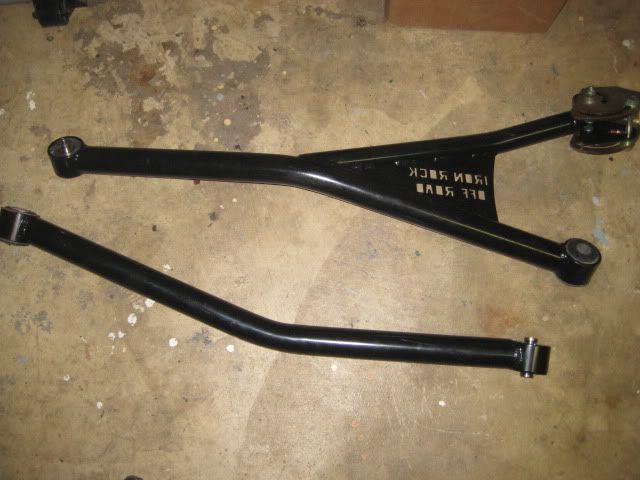

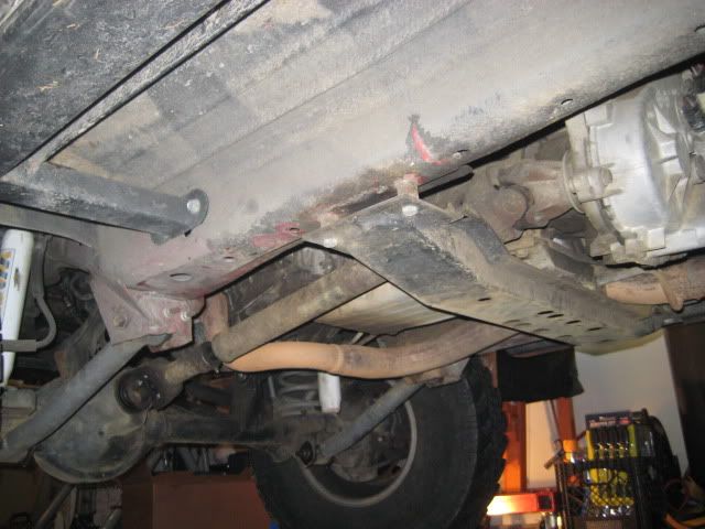

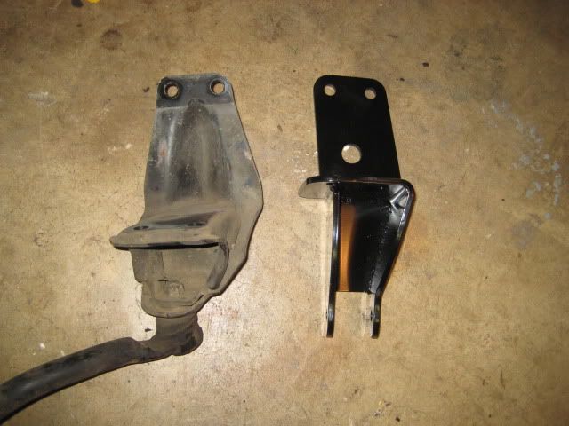

As you can see I dont sit too long with a project. They tend to get done fairly quick, faster then I load pictures cause I am lazy with that sometimes. Oh my gosh did I have fun with this one. I fought my Y-arm for like 2 hours. The 3 piece Cross-member is freaking sweet, its made so I can leave my long arms attached to the unibody and be able to remove the center section so I can get my transmission or transfer case out! Also another design that's sweet is the Caster adjuster on the top of my Y-arm. The rest of the front was easy as pie. The other arm took like 10 minutes. the shocks, springs, track bar bracket, track bar, and brake lines went in perfect. I haven't seen it on my tires yet but I imagine its going to be up there. I mocked up the back in the shop and it sits 3" higher then before I hope I dont tip over, knock on wood. Its now a 3-link setup in the front since I dont have the passenger side upper arm. Here it is before all the new stuff. This is the 3-piece cross member I was talking about and a shot of it mounted up. Side by side comparison to the stock track bar bracket compared to the new one which is much stronger. This is how the Y-arm looks and you can see the Caster adjuster on the top of the arm. Here is a shot of the springs old and new. Sitting on stock jeep wheels and tires, gives you an idea of how much lift it is from stock. 33's will fit perfect with no fender cutting. It also has plenty of room for 35's with some cutting.

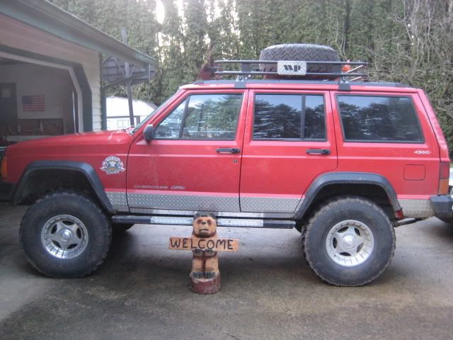

I finally got over the shock of a 400 buck alignment and brake flush....and gathered my senses. I snapped this photo on my phone a day ago. It can go further but the wall wasn't getting higher so I stopped.
